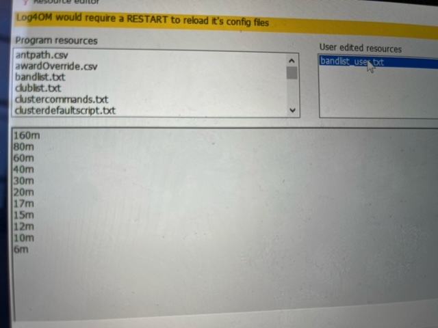

yo2oxd wrote: 06 Nov 2022, 08:42 Hi,
I removed a number of bands from log4om because I didn't have antenna for them. I edited the file bandlist.txt in resource editor and restarted the program. Now that I want to add back a band, I went and edited the file again, restarted, but the band doesn't reappear. It is not showing in the map view or in the qso entry window. If I insert the rx/tx frequency of that qso it will appear in the band drop-down, but only for that qso. How do I reset the bands?
Just highlight the user file in the resources editor and click on trash can icon - this deletes the user file
Now select the default file from left window and edit - save file when finished editing

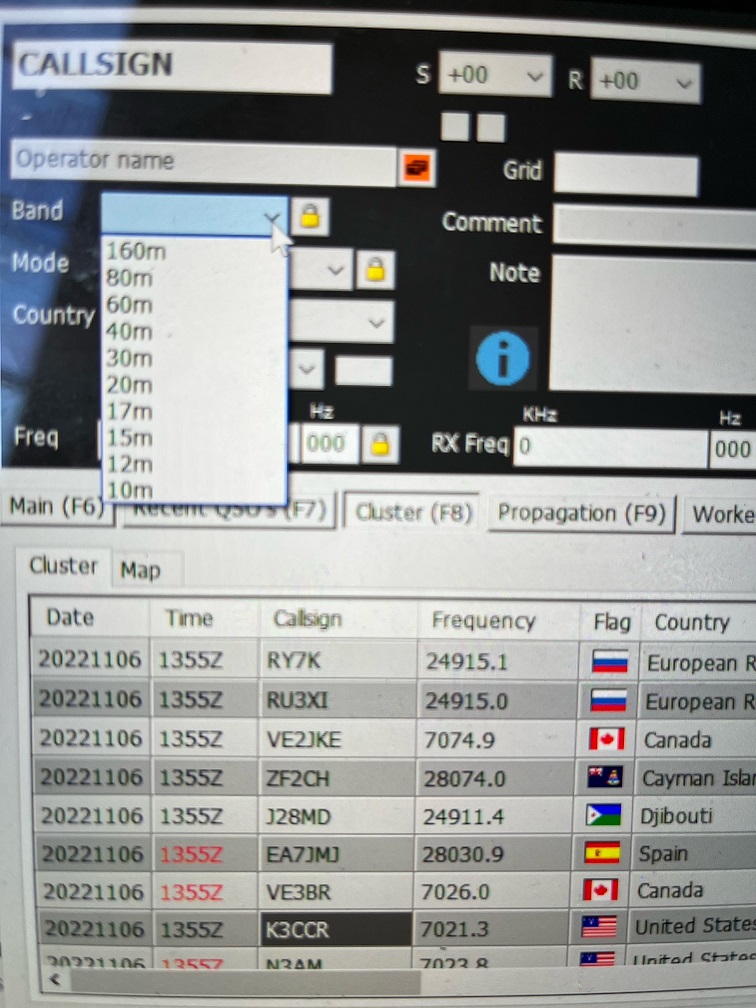

image attached
yo2oxd
Posts: 18
Joined: 05 Nov 2022, 16:58
Re: re-adding bands
Post by yo2oxd »
another image

bandlist_user file

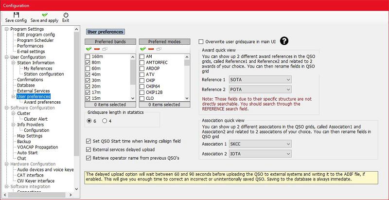

Re: re-adding bands
Settings/program config and I think user settings check the band boxes required

Re: re-adding bands
yo2oxd wrote: 06 Nov 2022, 15:11
G4POP wrote: 06 Nov 2022, 14:22 Settings/program config and I think user settings check the band boxes required
I cannot find a user settings location with band boxes to check in the program config?!
Here 'tis ...
