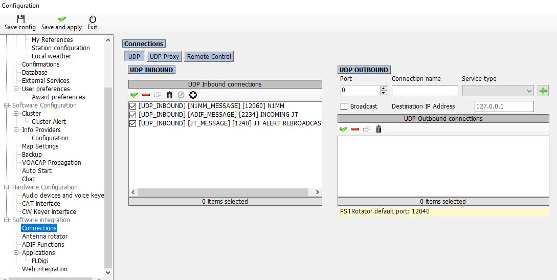

Jim & Bob -
Major changes were made with respect to UDP Inbound connections. This has been discussed time and time and time again on the Forum. The information was also presented in the Release Notes with V 2.27.0.0.
The setting up and configuration of the UDP Inbound connections has been made far simpler. But y'all have to remember to read the Release Notes and even take some time to scan the "most current" User Guide if you have more questions.
Here is a link (from Release Notes) that talks about the basics an OM has to do when it comes to the UDP Inbound connections. https://forum.log4om.com/viewtopic.php?t=8260
Bottom line is that you have to REMOVE what you have in place and then use the Inbound Connection routine and select the Preset Config options. You can still adjust items selected in those presets if you have the need to do so.
Be sure to first note what UDP ports you are currently using to link WSJTx, JTDX, Gridtracker and/or JTAlert.
Then DELETE those existing UDP connections and then build new ones.
The "current" User Guide is dated: 17/06/2023 11:39 AM
The Integration with the JT programs starts on Page 216 of that U.G.
Rolling back to V 2.27.0.0 will not resolve the issue. Nor will any Windows O/S updates help. You have to follow the directions and my very quick summary noted above.
Here is a link to the Log4OM website/resources page. https://www.log4om.com/resources/ Click on the tab labeled: "Working With JT Applications" and download that PDF. Lele created that document as a bit of an explanation of the JT applications UDP connections.

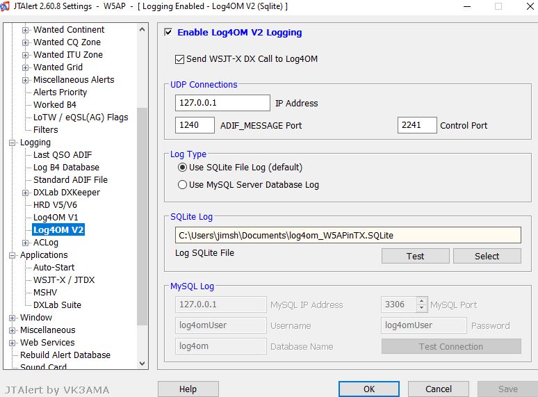

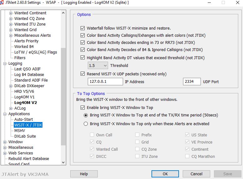

My WSJT-X settings: UDP server 127.0.0.1 port 2237 (all three boxes checked) Secondary UDP server(deprecated)
127.0.0.1 port 2241 (I had also tried different ports here, but this came from the example in the UM
I don't understand the differences (and maybe that's not necessary) between ADIF/JT messages and any of the other formats as do they all use UDP or are they different...
Anyway, thanks for your help
es 73, Jim

- JT ALERT APPICATIONS WSJTX JTDX.JPG (102.7 KiB) Viewed 1168 times
- Log4OM connections.JPG (86.23 KiB) Viewed 1168 times
- jt alert Log4OM setup.JPG (89.08 KiB) Viewed 1168 times
