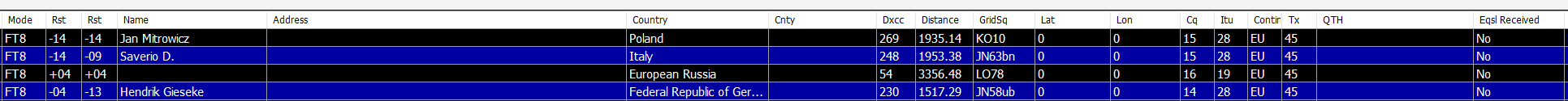

But since I updated to Version 2.28.0 a couple of weeks ago it has stopped Adding the QTH and Address and other details to the logged contacts
Also it no longer uploads them to QRZ - LOTW - Etc I have to manauly upload then from QSL Manager at the end of the session.

- log4om.png (15.58 KiB) Viewed 818 times

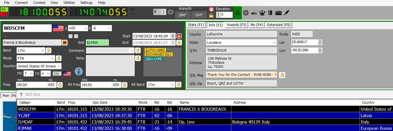

Yes look is working on Lookup F2 See screen shot just not saving it.
if I go in to QSO manager tagg all the blanks ones and then click un update it looks them all up and fills in the blanks.
The IU4DAF I updated via QSO Manager
The YL2KF and WD5CFM are just as logged, once done QSO Update all data was filled in

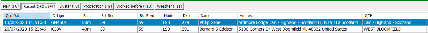

- log40 2.png (79.09 KiB) Viewed 790 times
