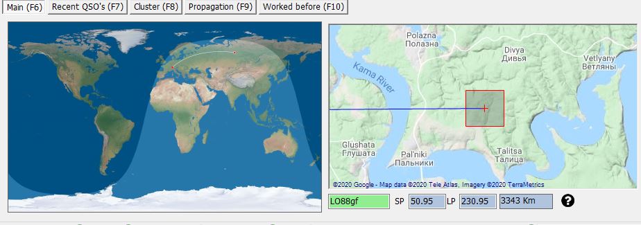

i have log4omV2 2.3.0.0 problems
ES2HV
no grid1.jpg (79.77 KiB) Viewed 5886 times
no flag1.jpg (49.96 KiB) Viewed 5886 times

the incoming call flag is missing and does not show the grid on the map. Previous version showed log4omv2 2.2.0.0

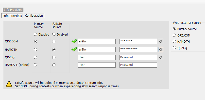

What are your Info Provider settings ?

settings

https://www.qrz.com/page/subscriptions.html
If you don't wanna pay for qrz.com sub then change your primary to HAMQTH

Running program - I restarted "run as administrator" and then started to function ... for TNX suggestions ...

I am not running Log4OM with administrator privileges and all works fine....
Seems something is strange with your setup.

Looks like you are running QRZ as primary and I do not see you have a subscription on your QRZ.com page.
