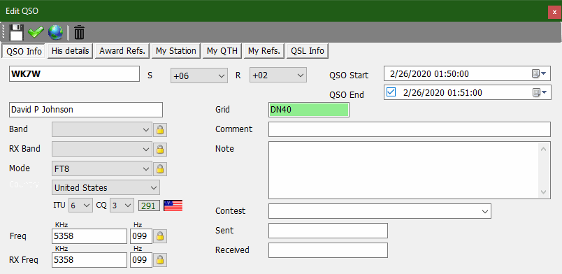

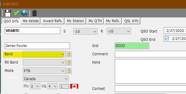

If I make a 60 meter contact the band does not show up in the EDIT QSO window but does get displayed in the
Recent QSO window. If I try to add it manually it will not stay. This only occurs with 60 meters.

You don't show the frequency in your screen shot, is there one?

Yes freq is captured in all instances..

I can confirm.
Band does not show up for me either.
Oddly enough you can see 60m flicker in the band location as the window opens but is blank after.

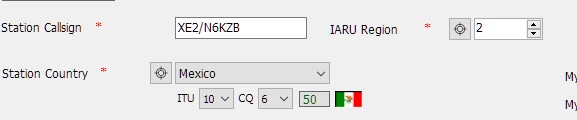

what is your ITU zone selection?

In my case information is:
Callsign: M0GWC
IARU: 1
Station Country: England
ITU: 27
CQ: 14
Graham
