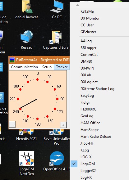

Thanks Manuel
Yes I have set Log4OM to Tracker menu from PSTRotator

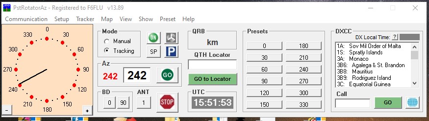

Yes I selected "Tracking" in the PSTRotator
PstRotator interface.jpg (68.99 KiB) Viewed 4859 times
But if I write a call into Log4OM and click on Azimut Field nothing is happening ...

I found the problem;
obviously there was a blank character in the port number.
Is there no verification that this port number is numeric?
Thanks to everyone who tried to help me
