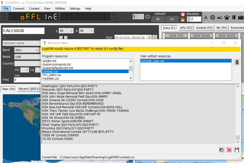

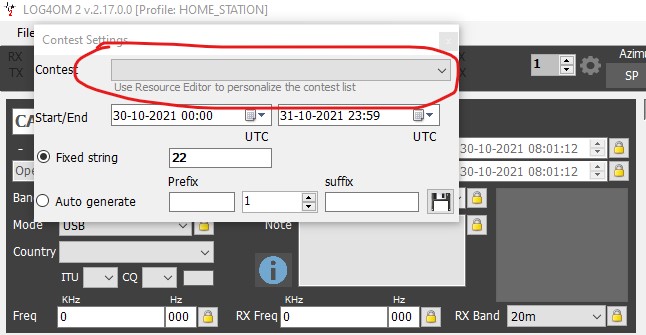

I am using Log4OM NextGen ver 2.17.0.0. I am unable to setup Contests using the Contest->Contest Settings option. In the Contest drop down no contest names appear. I even reinstalled Log4OM but issue persists. When I use resource editor I am able to see the default list of contests.
Screen images are attached. I have never faced this issue earlier.

I had used the contest configuration options earlier. I could chose the contest name in the drop down and then set the parameters like date of operation, serial numbers etc. Earlier I used to edit the contests.csv file using Notepad++. Even after doing that the contests used to appear in the drop down.

You will find a contest_user file in your roaming/lo4om folder delete or rename it and restart Log4om

Thank you!! This worked.
