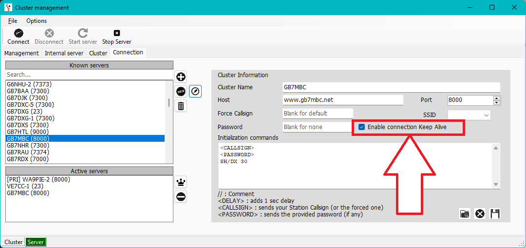

Do you have 'Enable connection keep alive' checked?

Post by W1BKW »
Keep Alive was checked but the rest of the fields were blank so I edited the form and and saved it and reconnected on the U GB7MBC: 8000 and reconnected. Will monitor.
