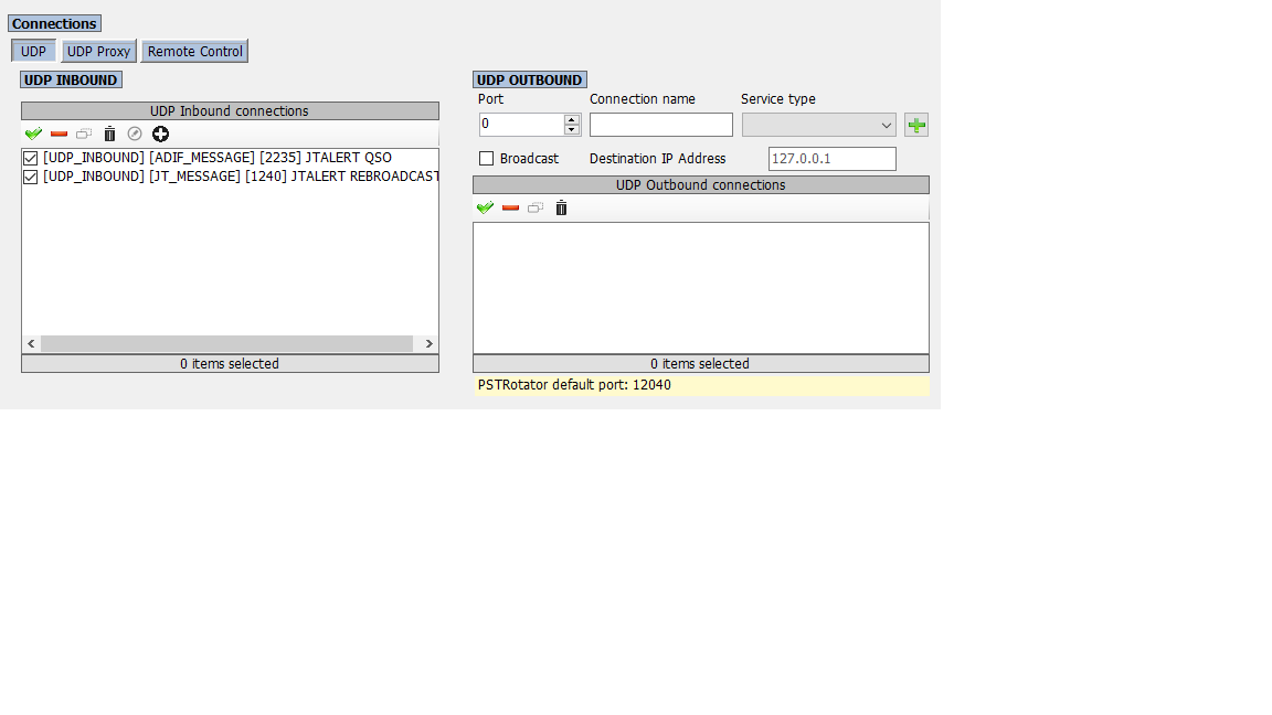

Hello Mr Terry, this is my situation on Log4OM:
UDP Connections.png (19.56 KiB) Viewed 6002 times

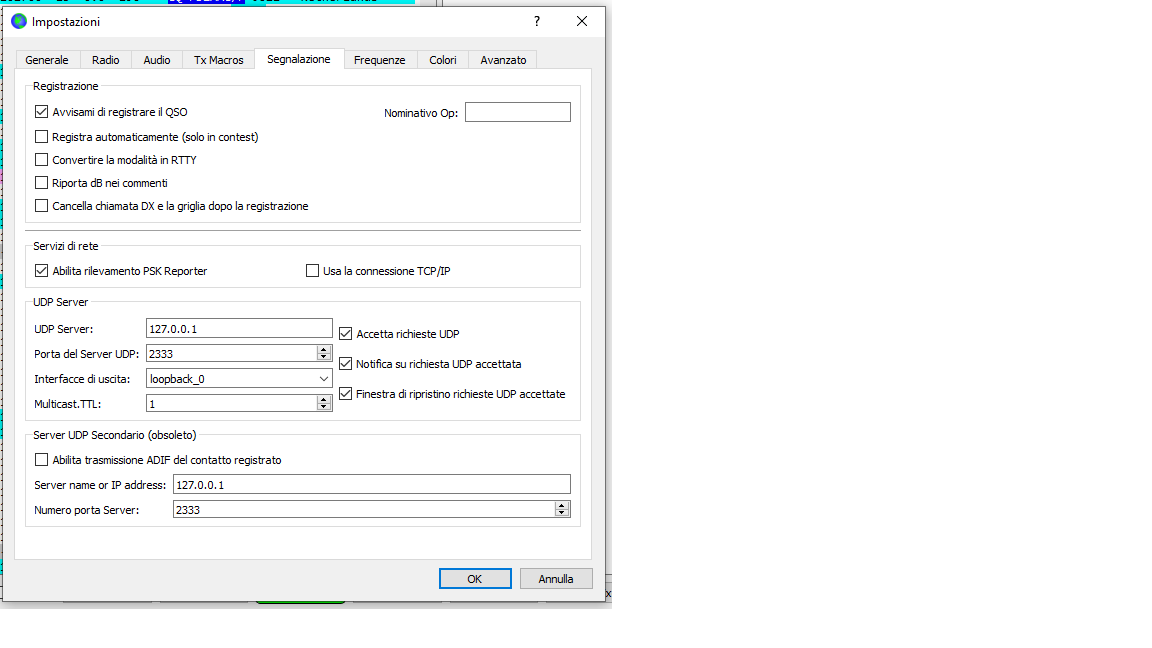

This on WSJT-X:

UDP WSJT-X.png (27.29 KiB) Viewed 6002 times

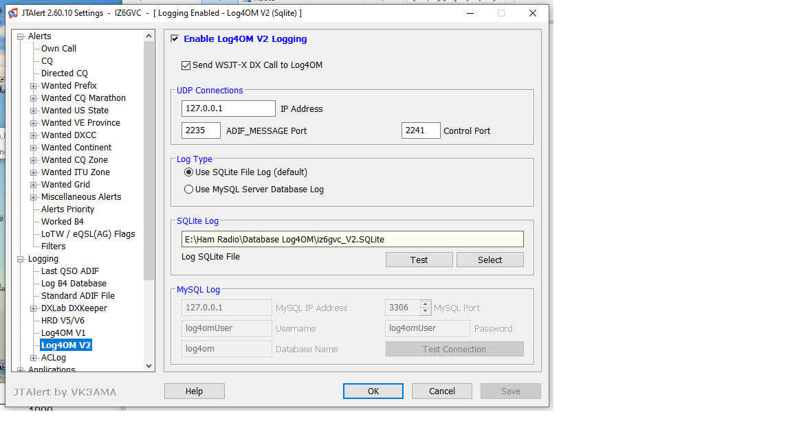

This on JTAlert:
Logging JTAlert 1.png (71.49 KiB) Viewed 6002 times

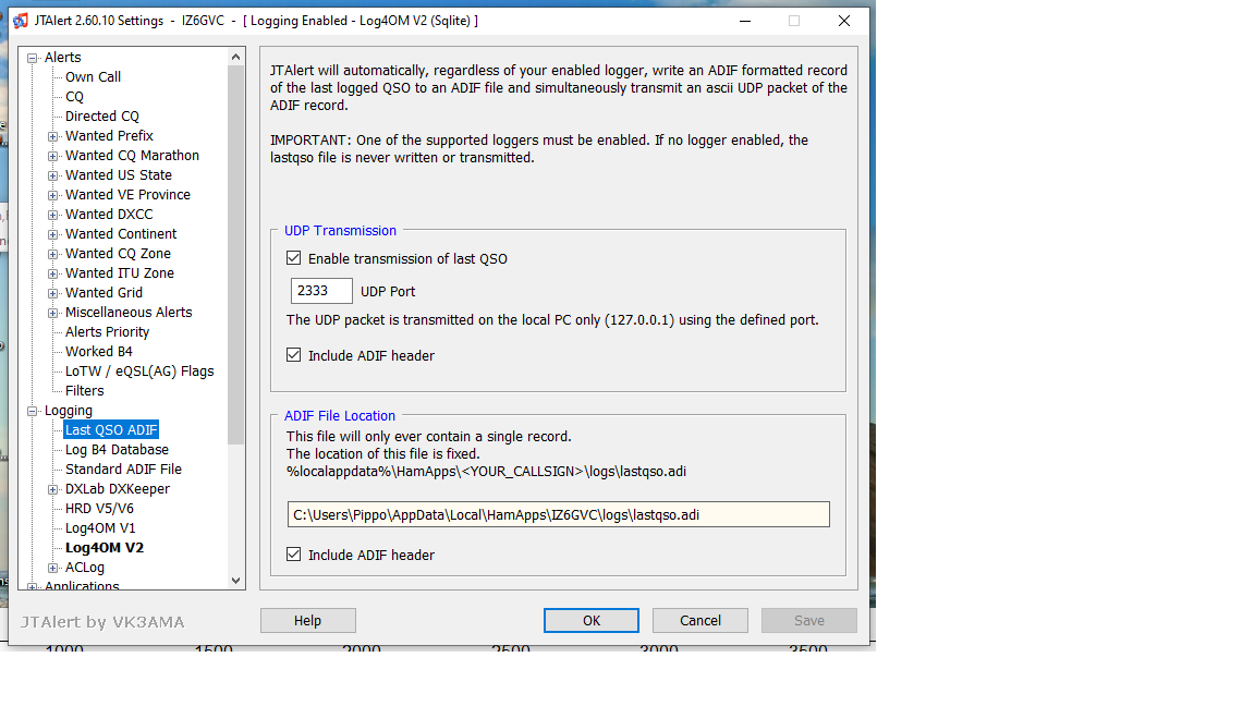

Continue JTAlert Connections:
Logging JTAlert 2.png (55.48 KiB) Viewed 6003 times

Posts: 11582
Re: Double on logging
In JTAlert/Last QSO ADIF
UNCHECK all four check boxes
Your logging twice from JTAlert, you only need to use the specific JTAlert Log4OM menu and log to SQLite file

Hello Mr Terry, no changes are made with your suggestion.
No Change Double Logging.png (61.77 KiB) Viewed 5985 times
