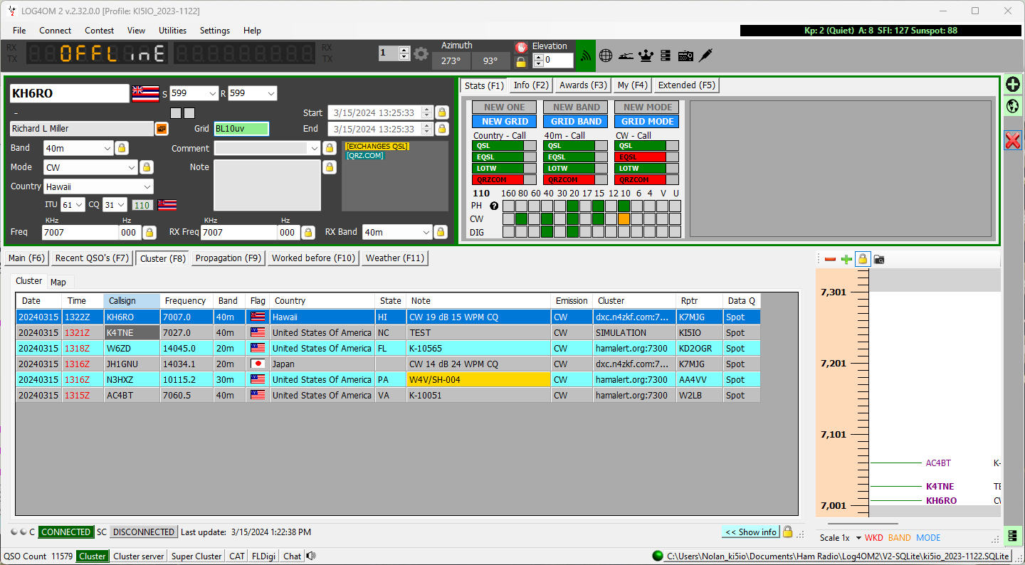

James,
I just installed the same/latest release as you have noted and the Main UI lookups are working FB here.
Maybe try a re-installation of the new release?
