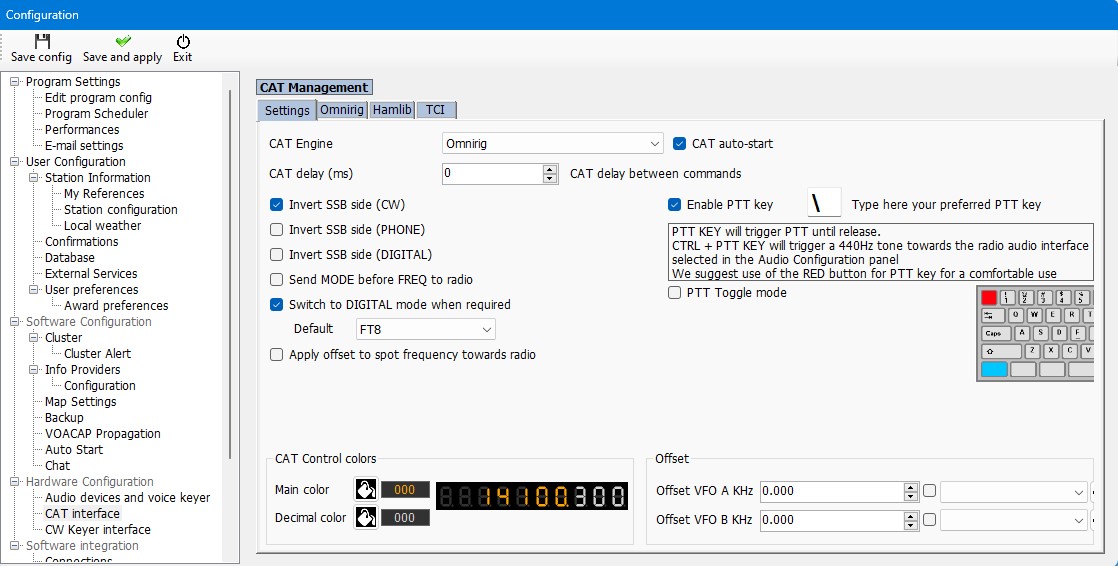

Re: Mode Change from Cluster
I have hopefully attached a screen shot of the CAT Management tab in Configurations. Which setting should I change?
- Log4OM CAT Management.jpg (146.82 KiB) Viewed 1435 times
It says "Switch to Digital" already. What am I missing?

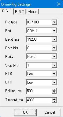

Here is my Omnirig panel. I WAS using Hamlib on the old computer. I started using Omnirig on THIS computer a couple of months ago. I was working fine until one day rescently. I just turned on the computer and this started happening. I mean I can manually switch the mode back to USB-DATA but selecting a station in the cluster should put me in the proper mode. I DOES for any other mode except FT8/4.
1) Is there a setting in the Cluster that needs to be changed?
2) Is there a .ini or registry file that needs to be checked?
3) Would it be better to use Hamlib?
4) Do I ask too many question for a guy from Nebraska?
Thanks,
Steve N6RSH

Try changing the setting that I referred to from FT8 to something else!
Steve,
You might could also try the IC-7300-DATA ini from the Omni-Rig Settings.
They provide the different ini's due to programming options from what I've seen.
Thanks, Nolan
That did the trick. Changing to IC-7300-DATA works. I can now go to ANY mode from the cluster now. I don't know how it changed, but I am getting old and probably don't remember if/when I did it.
