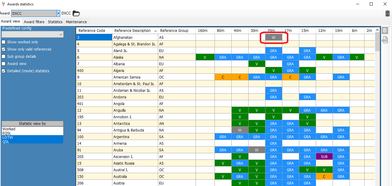

Here is another approach. if you want a visual clue to needed confirmations, go to Award Statistics, select DXCC, and look for worked (W) and not confirmed QSL's. i.e. look for any countries with only a W cell.

Yes, I know what you mean. As far as I know, there is no report that would give you a list of worked, but unconfirmed countries. Or Worked but unconfirmed Band/Countries. That might be something to add to the feature request section.
I basically use the Award Statistics view I posted above, click on each W cell to get the QSO info, then proceed to figure out how I can confirm them.

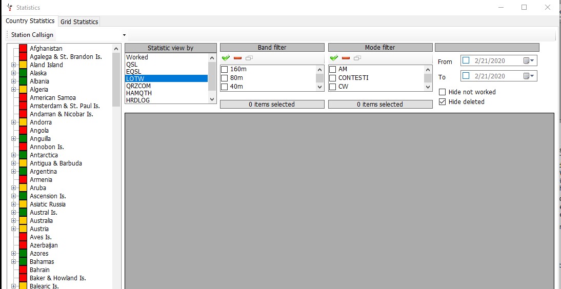

Boy this is one request I've wanted for a long time. A way to get a report of my countries needed for DXCC. There HAS to be a filter for it. Look at the Statistics window. Right there on the Country Statistics is the data displayed in a graphical tree form.
Annotation 2020-02-21 095019.jpg (94.42 KiB) Viewed 3563 times
All those DXCC entities marked Red - those are them. If I could only get a text report out of this screen I'd have what I want. (I could tack that paper up in my office and when I see Andarman & Nicobar Is. pop up on the cluster, tell the boss I've suddenly caught the flu and need to go home!)
